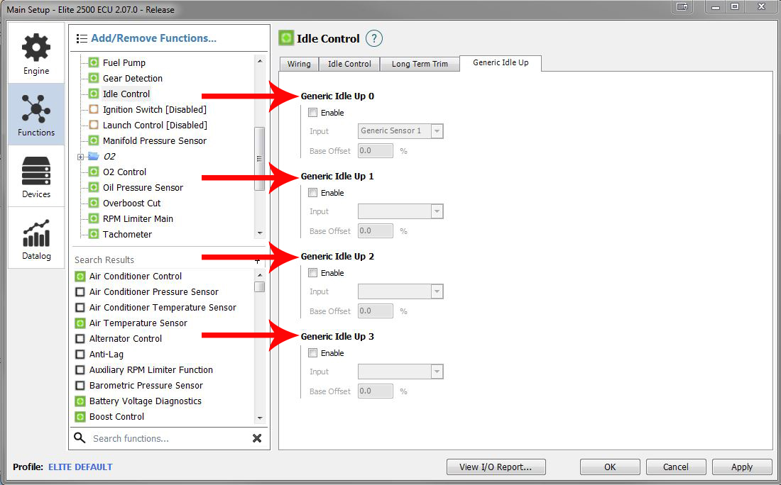

Message In the idle setup section of the elite there are 4 generic idle ups that you can arm based on a certain input being in an active state. IE: AC or power steering or it being Tuesday....whatever.
I have already set all of this up on my Supra and it works just fine. Now that I know what the adjustable RPM range is only using the AAC this wont be a problem at all. Just add in X percent over my base RPM and everything is done.
